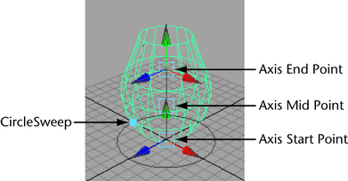

Tips
- If you move the axis endpoints, the axis direction is modified. However, if you move the axis midpoints, the radius of the revolved surface is modified without affecting the axis direction.
