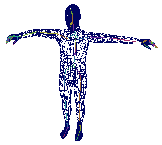

Rigid skinning provides articulated deformation effects by enabling joints to influence sets of deformable object points.
Rigid skinning is commonly used for objects or characters that require a rigid or mechanical movement, such as a robot or a vehicle. It can also be used for certain parts of characters, like armor pieces, where you want to maintain a fixed relationship between the mesh and the skeleton.
To see an example, click Example: Skinning a cylinder by rigid skinning.
With rigid skinning, only one joint can influence each CV, vertex, or lattice point. This provides rigid deformation effects that you can smooth by using lattice deformers, cluster deformers, or flexors.
