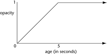

CloudShape.opacity = linstep(0,5,age);
This expression increases the per object Opacity attribute of CloudShape in equal steps from 0 to 1 for the first 5 seconds of the object’s existence. Because you created the object with the Particle Tool, the particles existence begins in the first frame of the animation.
All particles in the object fade in from transparent to opaque for the first 5 seconds of animation.
At the first frame that plays, the age of the particles is 0, so the linstep function returns 0 for the Opacity. An Opacity of 0 is transparent.
In each subsequent frame, the linstep function returns a proportionally larger opacity value. When the age of the object reaches 5, the linstep function returns 1 for the opacity. An opacity of 1 is 100% opaque.
When the age exceeds 5, the linstep function returns 1. The opacity stays 100% opaque. Here are some values returned for the object’s opacity:

As the table shows, the opacity increases in linear increments for the first 5 seconds of the object’s age. At the midpoint of the specified 0 to 5 second age range, the opacity is 0.5. At 3/4 of the way between 0 and 5 seconds, the opacity is 0.75. At 5 seconds of the object’s age, opacity is 1. After 5 seconds, the opacity stays at 1.

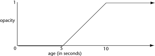

Suppose you edit the runtime expression as follows:
CloudShape.opacity = linstep(5,10,age);
This increases the Opacity attribute linearly from 0 to 1 as the object’s age increases from 5 to 10 seconds.

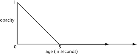

particleShape1.opacity = 1-linstep(0,5,age);
This decreases the Opacity attribute linearly from 1 to 0 for the first 5 seconds of the object’s age. Subtracting linstep(0,5,age) from 1 causes the opacity to fade out rather than fade in.
