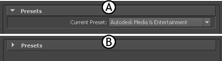

Expand/Collapse
Use this option to change whether the group or option is expanded (A) or collapsed (B) by default in the UI.

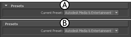

View as expandable group/View as expanded Panel
Use this option to set whether a group is expandable (A) or not (B).
