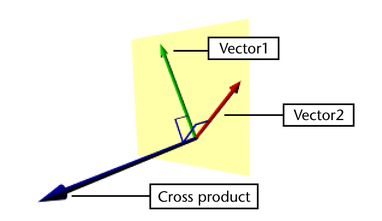

Returns the cross product of two vectors.
For two vectors, the cross product returns the vector that’s normal to the plane defined by the two vectors.
vector cross(vector vector1, vector vector2)
If the cross product is 0, the two vectors are parallel or colinear. If one or both vectors are <<0,0,0>>, the cross product returns <<0,0,0>>.
