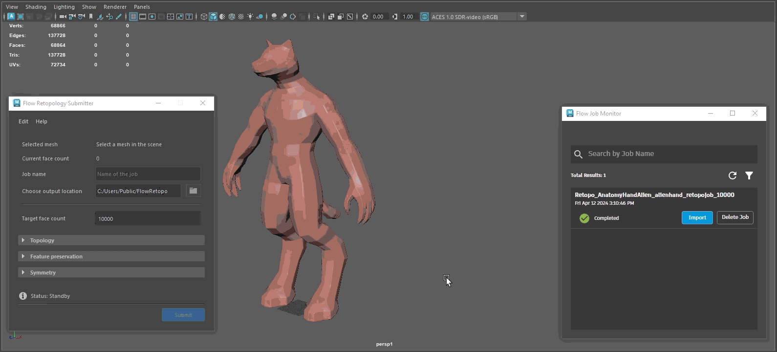

How will I be notified that my job is complete?
  • You can check on the Flow Job Monitor window and periodically refresh the window to stay up to date on your job progress. Job progress status is indicated and once complete, the job will have the completed checkmark.
Where is my file stored?
  • You can choose the location on disk of where your job is stored when complete in the Flow Retopology Submitter dialog, under Choose Output Location. Navigate to the directory of your choice where your completed job will be saved on disk. Your completed job will be saved with a suffix of _RESULT so you can easily distinguish it once complete.
