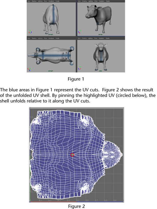

Plan your cuts to obtain the best unfolded result. The better the cuts, the better the correlation between the original mesh and its corresponding UV shell. Anticipate that cuts will result in texture mismatches along edges, and locate edges on the model where they are least visible. For example, make cuts under the arms or on the back of the legs of a character. ![]() |

Pinned UVs provide an anchor around which other UVs can be unfolded. If you don't pin at least one UV when unfolding a UV shell, the shell may unfold into a very tiny mesh or an undesirable shape. For symmetrical meshes, pinning UVs along the line of symmetry maintains the shape of the shell. Note: Pinning options are only available when you use the

Use the UV Toolkit's Align & Snap options to snap UVs to match any vertical or horizontal lines that would naturally occur on the texture. See Align UVs options. Tip: You can align UV edges that run down the axis of symmetry. For example, the line of UVs that run down the spine of a symmetrical four-legged animal, can be selected, aligned. and then pinned so they act as a benchmark for further unfold operations.
