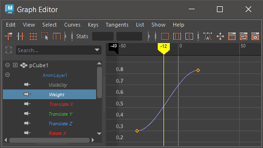

To view the layer’s Weight animation in the Graph Editor
  1. Open the Graph Editor.
  2. Right-click the Outliner area and select Display>Animation Layers Filter > Show Layer Weight if it is not already on.
    A purple attribute named Weight appears at the top of the Outliner list and the layer’s Weight Curve displays.
    The Animation Layer Weight shown as a curve in the Graph Editor
