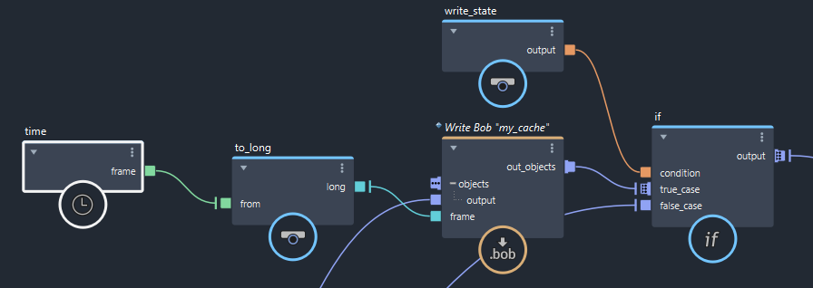

Writing files using batch execution
Batch execution lets you write out cache and other files without the risk of accidentally overwriting them. This process uses the write_state
job port, which is managed by Bifrost and set to true
during batch execution.
It requires some preparation in your graph:
- If you are using
file_cache
nodes, set theirmode
to the new Write State Mode. - If you are using
write_*
nodes, useif
nodes to execute them only when the output ofwrite_state
is true.

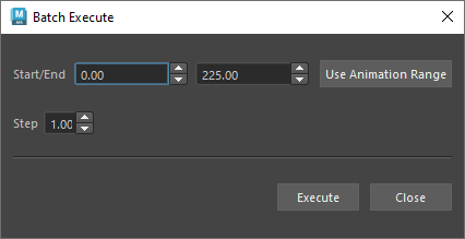

To write files using batch execution:
- Choose Edit > Batch Execute.
- Specify the time range.
- Click Execute. The
write_state
job port is temporarily set totrue
while the files are being written.
You can cancel batch execution in progress by choosing Edit > Cancel Batch Execute.
