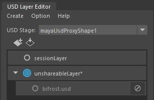

When you connect a stage as a new port on the output node of a Bifrost graph, a Maya USD proxy is automatically created in the scene and connected to the graph output. By default, the Bifrost stage is included as a sublayer of an unshareable layer of the proxy.
Bifrost stage in unshareable layer
The unshareable layer is used to store modifications made in Maya. For example, if you move an object from the Bifrost stage in Maya's viewport, or select a variant, those changes are stored as overrides in the unshareable layer.

Maya's USD Layer Editor shows that the layer from Bifrost is now shared:
