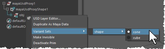

You can also select the variant on-the-fly in the host scene. Right-click on the variant container in Maya's outliner (its icon has an overlaid badge to show that it has variants), and select an option from the Variant Set menu. Like any other change made in Maya, this is not stored in the stage output from the graph.
