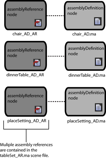

The following image illustrates a simple assembly reference.

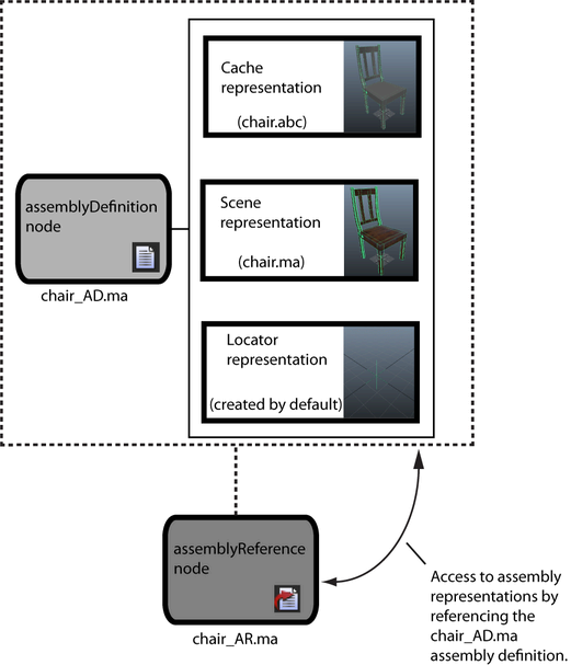

Assembly definitions define the list of assembly representations available for each asset or type of asset. For example, you may have a number of different types of chairs you want to use in a scene or production. This list of chairs is available in the assembly definition, which is a Maya scene file so that you have the convenience of viewing the available representations. While an assembly reference is the principle object for the asset type. You populate scenes with the assembly references and they are the objects you manipulate while assembling a layout or shot.

- Any number of assembly references can point to a single assemblyDefinition node.
