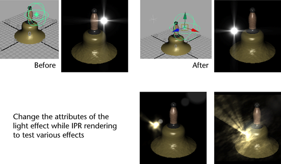

Re-position an optical light effect
You can move the glow or halo you have attached to a light or include more than one optical effect in the scene.
To re-position an Optical FX utility node
- Create a
Locator and place it anywhere in the scene (Create > Locator).
- Shift-select the locator in the view, then select the light.
You can now move the locator anywhere in the scene and the optical light effect moves with it.
