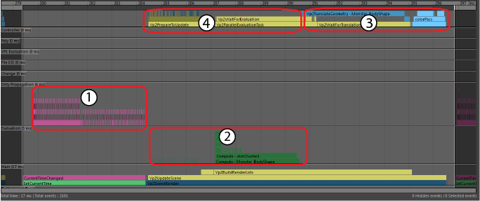

EM Parallel Evaluation
In this EM Parallel Evaluation profile, all the purple and pink Dirty Propagation events are gone. And instead we see:
  1. Peach, tan, and brown EM Parallel Evaluation events of the FK rig colored. The high stack of events represents some evaluation occurring in parallel.
  2. Tan and brown EM Parallel Evaluation events occur when Maya evaluates the skin cluster to compute the deformed mesh. These events occur serially because the Dependency Graph has no parallelism.
  3. Dark blue and blue VP2 Direct Update events translate data into a VP2 render-able format.
  4. Yellow in the Main category and light blue in the VP2 Evaluation category are VP2 Rendering events.
In this example, much less time is spent on Vp2SceneRender (4). This occurs because time spent reading data from dependency nodes has moved from rendering to EM Parallel Evaluation (1 and 2). DG evaluation uses a data pull model, while EM Evaluation uses a data push model. Additionally, some geometry translation (3), is also moved from rendering to evaluation. We call geometry translation during evaluation "VP2 Direct Update".

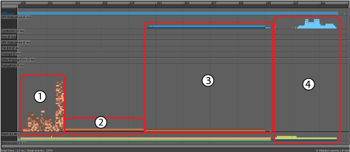

EM Parallel Evaluation with GPU Override
In this EM Parallel Evaluation profile, there is a major difference from the previous profile of EM Parallel Evaluation:
  1. Light and dark yellow GPU Override events have replaced the long serial central part of the EM Parallel Evaluation profile (2 & 3 from EM Parallel Evaluation). These GPU Override events represent the time the CPU takes to marshal data and launch the GPU computation.
  2. Peach, tan, and brown EM Parallel Evaluation events here have roughly the same duration as EM Parallel Evaluation, even though the relative size of the rig evaluation events with GPU Override is larger. This size difference is because the scale of this profile is different from the scale of the previous profile, 5 milliseconds versus 12 milliseconds.
  3. Light blue VP2 Render events have experienced a similar relative stretching (2).

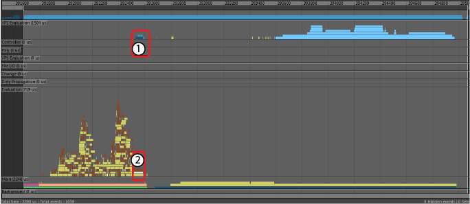

EM Evaluation Cached Playback
In this profile of EM Evaluation Cached Playback, there are several new event types:
  1. Yellow Restore Cache events record the time it takes to update each FK rig node which has cached data. There are also brown VP2 Direct Update events that track update of the VP2 representation of the data.
  2. Yellow Restore Cache event for the deformed mesh. This represents the time taken to restore the data into the Maya node, and to translate the data into VP2 for drawing using VP2 Direct Update.

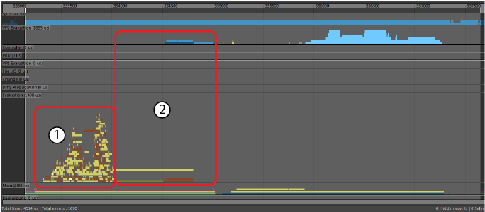

EM VP2 Hardware Cached Playback
  1. Dark blue VP2 Hardware Cache Restore events replace the long serial Cache Restore event (#2 from EM Evaluation Cached Playback, the section above). Restoring the VP2 Hardware Cache is much faster because the data is already in render-able format and stored on the GPU.
  2. Gray Cache Skipped event shows that data in the dependency node is not updated.

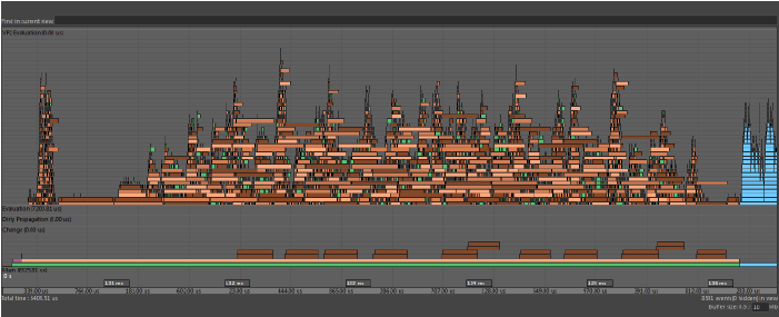

A scene is considered Evaluation-bound when the main bottleneck in your scene is evaluation. There are several problems that may lead to evaluation-bound performance.

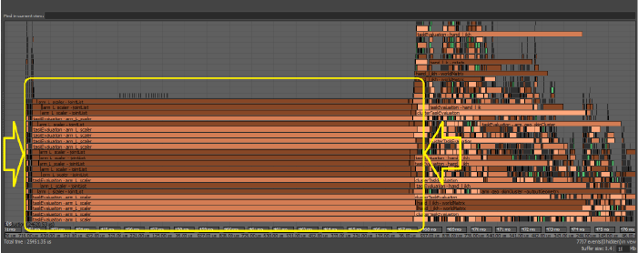

Lock Contention

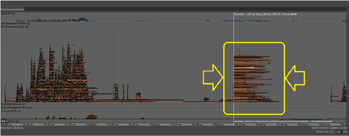

Lock Contention occurs when many threads try to access a shared resource, due to lock management overhead. You can identify this occurrence when evaluation takes roughly the same duration no matter which evaluation mode you use. Lock Contention occurs when threads cannot proceed until other threads are finished using the shared resource.
The above image shows many identical tasks starting at nearly the same time on different threads, each finishing at different times. This type of profile suggests there might be a shared resource that many threads need to access simultaneously.

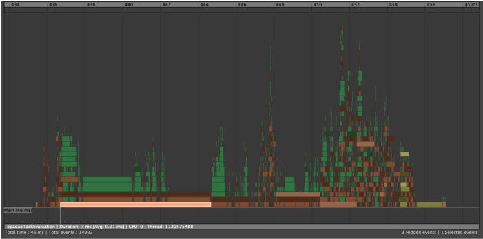

Clusters
If the Evaluation Graph contains node-level circular dependencies, those nodes are grouped into clusters that represent single units of work to be scheduled serially.
Although multiple clusters can evaluate at the same time, large clusters limit the amount of work that can be performed simultaneously. Clusters can be identified in the Profiler as bars with the opaqueTaskEvaluation label, shown below:
If your scene contains clusters, analyze the rig structure to locate any circularities. Ideally remove coupling between parts of the rig, so rig sections (for example, head, body, and so on,) can evaluate independently.

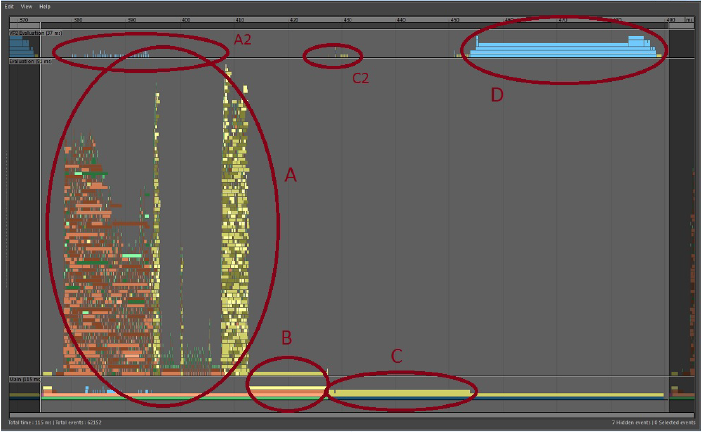

A scene is render-bound when the main bottleneck in your scene is rendering. The following Profiler example is expanded to a single frame taken from a large scene with many animated meshes. Because of the number of objects, different materials, and the amount of geometry, this scene is very costly to render.
The Profile example above has four main areas:
    1. Evaluation
    2. GPUOverridePostEval
    3. Vp2BuildRenderLists
    4. Vp2Draw3dBeautyPass
In this scene, many meshes are being evaluated with GPU Override so some Profiler blocks appear differently from what they would otherwise.
Evaluation
Area A shows the time spent computing the state of the Maya scene, which in this case, is moderately well-parallelized. The blocks in shades of orange and green represent the software evaluation of DG nodes. The yellow blocks are the tasks that initiate mesh evaluation via GPU Override. Mesh evaluation on the GPU starts with these yellow blocks and continues at the same time as the other work on the CPU.
An example of a parallel bottleneck in the scene evaluation appears in the gap in the center of the evaluation section. The large group of GPU Override blocks on the right depend on a single portion of the scene and must wait until it is complete.
Area A2 (above area A), are blue task blocks that show the work that VP2 does in parallel with the scene evaluation. In this scene, most of the mesh work is handled by GPU Override so it is mostly empty. When evaluating software meshes, this section shows the preparation of geometry buffers for rendering.
GPUOverridePostEval
GPU Override finalizes some of its work in Area B. The amount of time spent in this block varies with different GPU and driver combinations. At some point, there is a wait for the GPU to complete its evaluation if it is heavily loaded. This time may appear here, or it may show as additional time spent in the Vp2BuildRenderLists section.
Vp2BuildRenderLists
Area C. Once the scene is evaluated, VP2 builds the list of objects to render. Time in this section is proportional to the number of objects in the scene.
