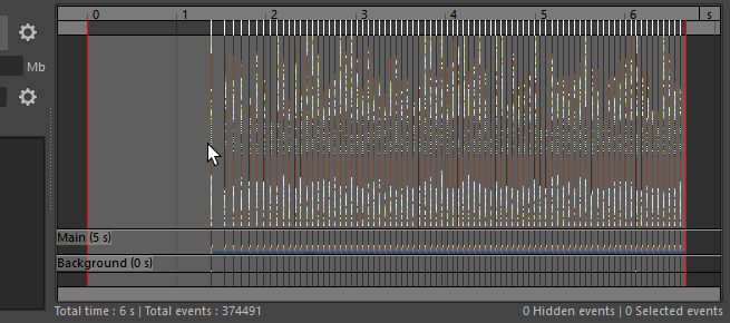

The Profiler lets you locate performance bottlenecks in your scene by recording and demonstrating in a graph the amount of time that each process consumes.
You can determine when to start and stop recording. You can also save your recording as a text file and reload it in the draw region at a later date. You can perform these tasks via the Profiler window or via the profiler MEL/Python command.

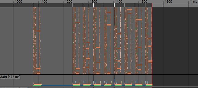

Graph your events in one of the following ways:
- Category view: displays the activities for different categories such as XGen, Bifrost and Qt. This is the default view.
- CPU view: displays the activities of each of your processors. Select this view to better evaluate multi-threading.
Note: CPU view is unavailable on Mac OSX.
- Thread view: displays the activities of each of your threads. Select this view to evaluate all the activity on a single thread.

| Switch among different graph views: Category view, CPU view, and Thread view |
Use the hotkeys 1, 2, 3 to switch among view modes. These options are also available from the View menu.

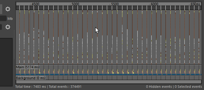

| Navigate in the draw region |
Shift + Alt + right-drag up/down to zoom vertically. Shift + Alt + right-drag left/right to zoom horizontally.

| Isolate or un-isolate a segment |
On the segment bar, click the segment that you want to isolate. Click it again on the segment bar to un-isolate it and return to the default view.
