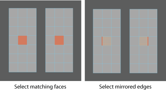

  2. Select a face on each shell.
    The faces must be matching.
  3. Select an adjacent edge to each selected face.
    The two edges must be mirrored.
