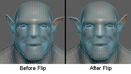

Alternatively, you can use
Mesh > Flip to swap the positions of the components instead.
