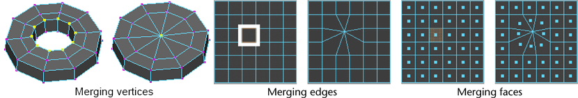

You can merge pre-selected vertices using the and commands. The former is useful for combining components that are very close or overlapping (like when merging a polygon mesh to a mirrored copy) while the latter is useful for filling holes or creating points.
Note: When you merge vertices, the corresponding UVs are also merged. In some cases, UVs cannot be merged. For example, UVs on separate shells must be merged manually. (Select

To merge several vertices at once
- Select the vertices you want to merge.
- Do one of the following:
- From the main menu bar, select .
- From the Vertex Marking Menu, select .
- In the Merge Vertices options window, adjust the Threshold.
- Click
Merge.
When the distance between the selected vertices is smaller than the Threshold value, they are merged.
Note: Merging vertices can make your geometry non-manifold. Use to fix non-manifold geometry. - In the In-View Editor that appears, adjust the polySewEdge node attributes.
To merge edges or faces into a single vertex
- Select the vertices, or the edges or faces bordering the vertices that you want to merge to a center point.
Note: You can only merge edges that are part of the same polygon mesh. If you want to merge edges from different mesh objects, you must first combine () them.
