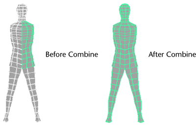

You can combine two or more polygon meshes into one polygon object using the Combine feature. The Combine feature assembles the meshes as polygon shells in the new polygon mesh node that gets created. The topology of the combined meshes is not modified in any other way.
In general, you must combine separate polygon meshes before you can perform many types of polygon editing operations. For example, if you wanted to merge the edges/vertices of two halves of a character, you must first Combine the meshes into one object.
