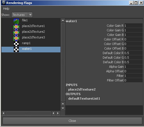

Rendering Flags Show list
Click the down arrow to display the Show menu, then select an item or items for which you want a list of attributes.
The attributes for these items are listed in the right panel where you can change and set them, much like in the Channel Box.

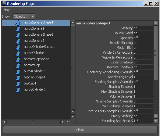

Rendering Flags window panels
The Rendering Flags window contains two panels. The left panel lists the items you select from the Show menu, and the right panel lists the attributes for the selected items. In the left panel, click the list item for which you want to change or set the attributes and the details display in the right panel.

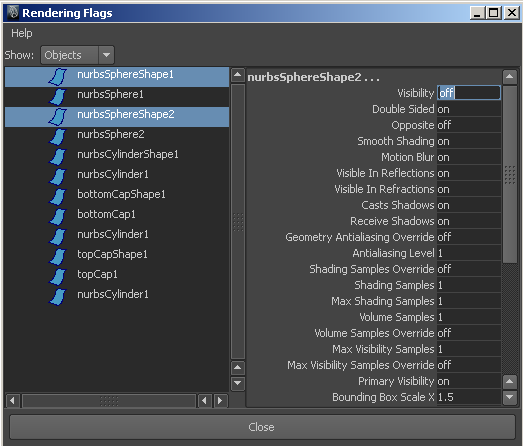

To set attributes for multiple nodes in the Rendering Flags window
- You can change or set attributes for several related objects by selecting them in the left panel, and setting the attribute value in the right panel. For example, if you want to turn the visibility off for two NURBS spheres in the scene, select both spheres from the left panel and type off beside Visibility in the right panel.
Once you change an attribute for a selected item, the heading changes color in the list reminding you of the change.
