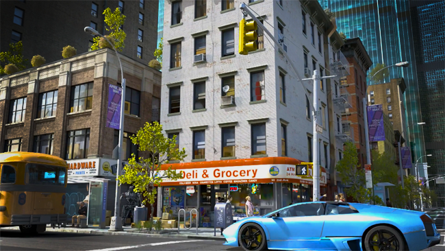

Rendering is the last step in bringing 3D models to life, where objects are shaded and textured, and the scene is lit.
Though the wider context of rendering begins with shading and texturing objects and lighting your scene, the rendering process ends when surfaces, materials, lights, and motion are processed into a final image or image sequence.
