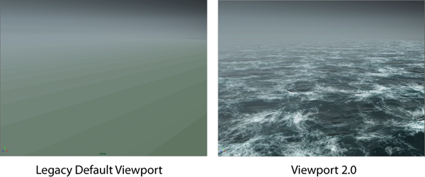

In the following image, you can see difference between the old and new viewports when an Ocean Shader is applied to a plane.
