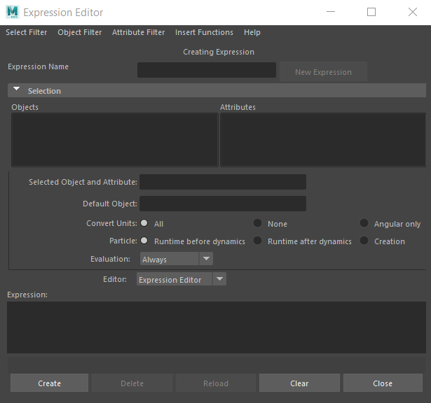

Delete an animation expression
You can delete an expression to stop it from controlling attributes.
To delete an expression
  1. Navigate to Windows > Animation Editors > Expression Editor.
  2. Select it in the Expression Editor.
  3. Click Delete.
    Tip: You can quickly delete all non-particle expressions from a scene. From Maya’s main menu bar, select Edit > Delete All by Type > Non-particle Expressions.
