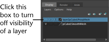

  1. When you create a subdiv proxy, ensure that the following options are enabled:
    • Subdiv Proxy In Layer
    • Smooth Mesh in Layer
    Maya adds both meshes to a new layer in the Layer Editor.
  2. In the Layer Editor, click the Display tab and click the visibility icon beside the name of each mesh.
