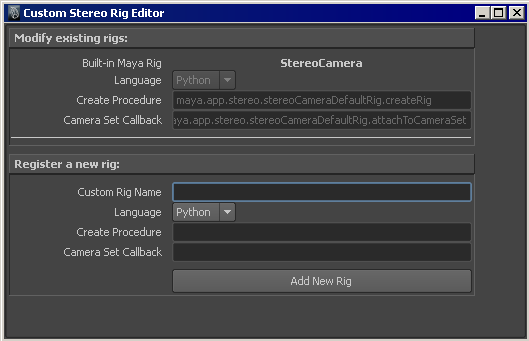

  1. Select Stereo > Editors > Custom Stereo Rig
    The Custom Stereo Rig Editor window appears.
  2. In the Register a new rig section, select a name for your custom rig. Select the language that you used to create your custom rig, either Python or MEL. Enter the Python or MEL procedure that you want to use to create your custom rig, for example:
    maya.app.stereo.stereoCameraComplexRig.createRig.
  3. In the Camera Set Callback section, assign a callback if you are using a multi-camera rig.
    Each custom rig can assign a callback that is called whenever that rig is attached to a camera set. A camera set holds onto the layers of a multi-camera rig, and contains slots that hold information pertinent to each layer. After a rig has been created and assigned to a layer of the multi-rig, this callback is executed to let the custom rig know that this has happened and allow for any custom actions to occur. This occurs for each layer in the multi-rig.
    After all mult-rigs have been created, one final callback is sent to the same method to indicate that Maya has finished creating the multi-rig. The syntax of the callback contains the following flags:
    Per-layer: <nameOfCallback> -cameraSet <multiRigName> <rigNodeName>
    Final callback: <nameOfCallbak> -cameraSet <multiRigName> -allDone 1
    For more information about multi-camera rigs, see Create a multi-camera rig and Multi-Camera Rig Tool.
  4. Click Add New Rig.
    You can now access your custom rig in by selecting Panels > Stereo > New Stereo Camera (<Your custom rig>).
