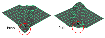

Push/pull
You can push or pull a mesh in a configurable direction in the shape of the tool.

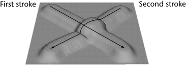

Sculpting simply pushes or pulls the surface’s vertices from their initial positions on the reference surface. The Maximum Displacement option controls how far vertices can get from the reference surface.
In this example, the two strokes both raise the surface to the maximum displacement distance, but not beyond it.

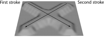

If you update the reference surface, the current state becomes the reference, and further sculpting will displace vertices from the new base point.
In this example, after the first stroke, the user updates the reference surface. The second stroke then applies the maximum displacement to it, going over the first stroke, which is now “baked onto” the reference surface.
You can update the reference surface manually, or set the Update on Each Stroke option to bake each stroke onto the reference as you finish the stroke.

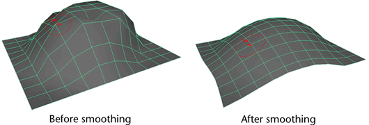

Smoothing
You can paint over bumps to smooth them out. This smoothing operation works by averaging the position of all features within the brush radius with all other nearby features.

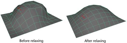

Relaxing
You can paint over bumps to relax the most out-of-place surface features. Unlike smoothing, Relax works by only averaging the largest surface anomalies so that the overall shape is maintained.

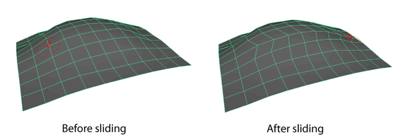

Sliding

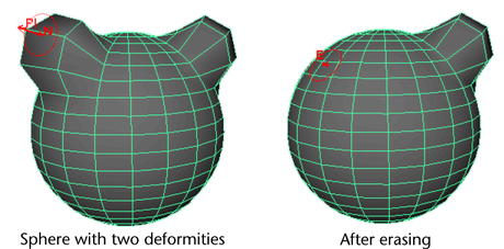

Erasing
You can save the state of a surface and then later erase changes to the surface back to the saved state.
You can also turn on an option to save erase state after every stroke, which allows you to erase only the last stroke you made.

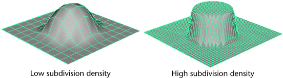

Surface density
In general, it’s advised that you minimize the number of patches/polygons in your surfaces whenever possible. However, when using the Sculpt Geometry Tool, the more polygons a surface has, the more precisely it can deform to the shape of the sculpting brush.
