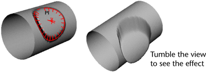

Operation
Select Push, Pull, Smooth, Relax, Pinch, Slide or Erase. A letter appears within the brush stamp to reflect the operation: Ps (Push), Pl (Pull), Sm (Smooth), Re (Relax), Pn (Pinch), Sl (Slide) or E (Erase).

Reference vector
In the Sculpt Parameters section, select the Reference Vector. The Reference Vector controls the direction the vertices move when you push or pull. The brush arrow represents the reference vector.
Normal
The vertices move in the direction of the surface normal.
First normal
The vertices move in the direction established by the surface normal at the beginning of the stroke.
View
The vertices move parallel to the camera view direction.
