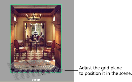

  7. Adjust the perspective camera so that the construction grid plane aligns approximately where you want to place the object.

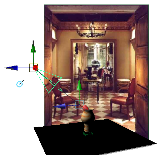

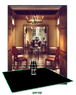

  8. Create and position a NURBS or polygonal plane on which to cast shadows and reflections.
  9. Position the object you want to cast shadows onto the stand-in geometry on the grid plane.
  10. In Hypershade, create a Use Background material and assign it to the plane.

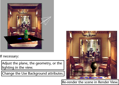

  11. Create and position lights in the scene. Turn on the Use Depth Map Shadows attribute in the Shadows section of the light’s Attribute Editor to see the shadows in the rendered result.
  12. Render the scene in Render View (for best results, do not IPR render).
  13. Adjust the location of the geometry, the lights, and the Use Background attributes if necessary and then re-render the scene at any time.
