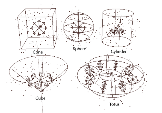

Emit nParticles from a volume shape
Volume emitters emit nParticles from a closed volume. You can choose from cube, sphere, cylinder, cone, and torus.
- Select
- Under Basic Emitter Attributes, set the Emitter type to Volume.
- Under
Volume Emitter Attributes, click
Volume shape and select a shape from the menu.
- Set the
Volume Emitter Attributes as desired and click
Create.
The implicit shape of the volume emitter is displayed on the screen. You can move, rotate, scale, or shear the emitter.
Note: You can’t deform the volume or use an arbitrary volume.
