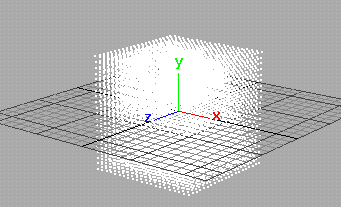

To create a 3D grid of particles by clicking in the workspace
- Turn on Create Particle Grid.
- Select Placement with cursor, if it is not already selected.
- Set the Particle Spacing value.
This sets the spacing (in units) between particles in the grid.
- In the perspective view, click the left mouse button at the lower left and upper right corners to specify the X and Z grid dimensions of the base or top of the 3D grid—don’t press
(Windows and Linux) or
(Mac OS X) yet. - Move the cursor into the front view or side view. Press the
(Mac OS X) key to enter edit mode. - Drag either the left or right point up or down to create the height of the grid. Do not drag both. To constrain placement, hold Shift down as you drag.
- Press
or
