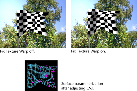

Note: Convert to File Texture does not support Fix Texture Warp If the surface uses Fix Texture Warp, it is ignored when converting the material.Fix Texture Warp adjusts a texture’s UV parameters so the texture does not rely on a NURBS object’s UV parameterization, which alleviates texture warp on objects with 2D textures. For example, if you want to create and animate a flag with a Checker texture, you can create a NURBS plane on which to map the Checker texture, transform the CVs, and turn Fix Texture Warp on in the object’s Attribute Editor.
When you animate the flag by moving some of the CVs to simulate the wind blowing the flag, the checker pattern on the flag expands and shrinks appropriately.

- Because computing exact arc-lengths is very expensive, Fix Texture Warp is a compromise used to achieve well spaced UV texture values with chord length (which measures the length of a line drawn between two points on the surface). Use this feature to apply textures more evenly on surfaces with uneven parameterization.
- Fix Texture Warp is applied on a per-NURBS surface basis.
