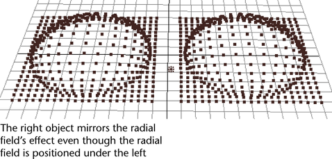

Example
Suppose you create a particle grid and connect it to a radial field positioned below it. You create a duplicate of the particle grid with Duplicate Input Connections, then move the duplicate grid to a new position. The right object mirrors the radial field’s effect even though the radial field is positioned under the left object.
