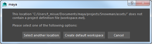

    If the directory you want to set as the current location does not already include a workspace.mel project definition file, Maya asks you to choose a different directory or create a project definition file for the specified directory.
  4. Do one of the following:
    • Click Select another location, and then browse to a directory that contains a project definition file.
    • Click Create default workspace to create a workspace.mel project definition file in the specified directory.
      Creating a project definition file in this manner does not automatically create project locations such as primary and secondary project locations. This means that the set project is more of a project placeholder than a proper Maya project. It is strongly recommended that you open the project in the Project Window, by selecting File > Project Window, review the settings, and accept them. See Create a new project.
