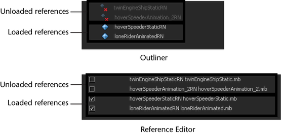

Loaded and unloaded references
After a child scene has been referenced into an open parent scene, the contents of the child scene are placed in memory and displayed in the scene. This initial state for a referenced file is referred to as being loaded. Other child scenes can be loaded in the open parent scene simultaneously. When a referenced scene is unloaded, the connection between the referenced child scene and the parent scene is suspended and the contents of the referenced scene file is no longer loaded in memory. You can load, unload, or re-load referenced child scenes from within the open parent scene file.
You can load and unload references from the Outliner or Reference Editor. See Load and unload file references.

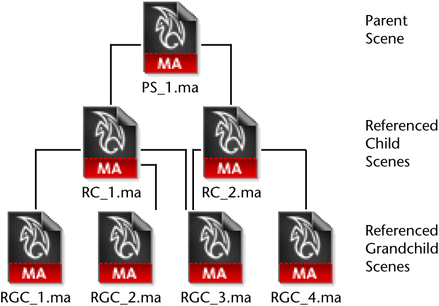

Reference hierarchies
Parent scenes can reference other parent scenes to create a hierarchy of nested references. A parent scene can both reference other files and be a referenced child of another parent scene based on its relative position within the file referencing hierarchy. When this occurs, the child scene files are referred to as grandchild scene files. This hierarchical referencing of a parent scene, child scenes, and other grandchild files is referred to as multi-level referencing.
A hierarchy of multi-level references is one method for segmenting various components and levels of display complexity within a large scene. See File hierarchy assembly.
Note:
A referenced file cannot reference its parent scene or any other file that resides above it in the reference hierarchy.
