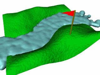

The Curve Flow effect emits particles that flow along a curve you create. You can use this effect to create flowing fluids, gases, or instanced objects. The emitted particles start at the first CV and end at the last CV you drew when you created the curve.
For example, to make water flow down a ravine, you would first create a NURBS or polygonal surface as the hill with a ravine. You then create a curve in the middle of the ravine from beginning to end. You use the Curve Flow effect on the curve and adjust the Curve Flow attributes. Finally, you select an appropriate render type such as Blobby Surface for the emitted particles and adjust their appearance.
It’s often useful to use the Curve Flow effect on the same curve more than once. By setting option settings differently with each usage, you can create a complex look not possible with a single usage.
Tip: You can use the Curve Flow effect on a curve or surface as a convenient way to guide the flow along deformed surfaces. It’s often helpful to duplicate the curve or surface, raise the copy above the surface, then apply the Curve Flow effect to the copy.
To keep particles flowing within a planar boundary, for instance, water flowing down a river, you can sandwich the curve between invisible planes and then make the particles collide with the planes. The particles bounce within the two invisible planes.
