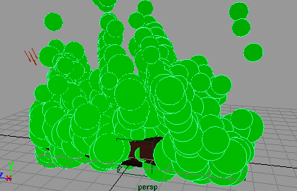

    Emitted particles appear as circles in the workspace because the particles are displayed as the Cloud render type.
    Here’s an example with Shading > Smooth Shade All turned on.
