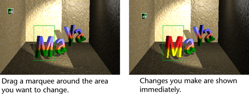

When you drag a marquee (render region) around the entire scene or part of the scene, the IPR image begins to update. If you change lights, shadows, materials, textures, and post processes (special effects) such as glow and fog, you can see the results of your changes interactively.

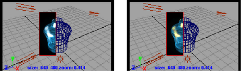

    • Click the scene view you want to render, then click the IPR Render button (from the Status Line or from within Render View if it is open). The scene appears in Render View, and an IPR image is created.

  2. Marquee select a region within the IPR rendered image in Render View.
    Note: You must select a region to adjust before you start to modify rendering attributes. The region you select determines the amount of memory required by IPR to re-render the adjusted region.
  3. Adjust the scene, for example, add lights or modify materials and texture attributes.
    The selected region of the IPR image updates as you adjust the scene.
    • To render another view instead, select IPR > IPR Render in Render View and select a view from the drop-down list.
    • If you change the view (such as tumble or zoom, or add new elements to the scene) and want to update the result, click the Redo Previous IPR Render icon in Render View or from the Render menu in Maya’s main menu bar.
    • If you only want to change certain elements such as lighting or textures and do not change the view, simply drag a marquee around the object or part of the object you want to update. The results in Render View are immediate.
