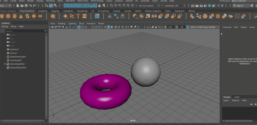

You can disable a light so that it does not affect your scene. Toggle
to enable or disable a light, or select the light and
toggle its
Enable attribute in the
Property Editor.
Disabled lights appear with a diagonal line pattern in the Light Editor.
Disable a light group to simultaneously disable all of its member lights. See Create and group lights in the Light Editor.
If you have partitioned your scene into layers using the render setup system, you can disable lights for individual layers by creating an override on the Enable attribute. See Render setup in Maya or Create light overrides in your render layer.
