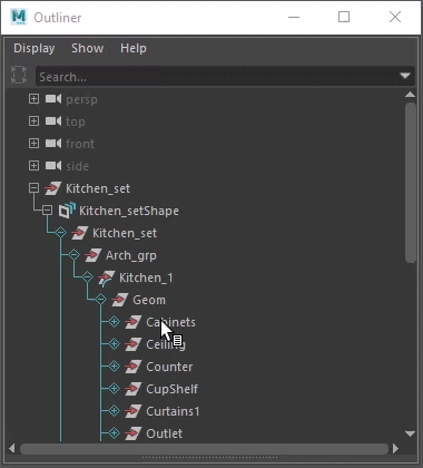

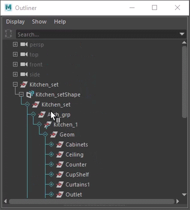

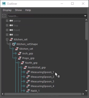

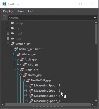

  1. To parent prims, do one of the following:
    • Middle-click drag and drop a prim to re-parent it.
    • Shift-select multiple prims and press P. The last prim you selected becomes the parent.
  2. To unparent a prim, do one of the following:
    • Parent the prim to the root of your stage
    • Select the prim you want to remove from the parent group, and press Shift+P

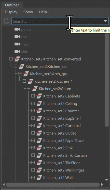

Search prims in the Outliner
To search for a prim in the Outliner, simply type the keyword in the search bar.
