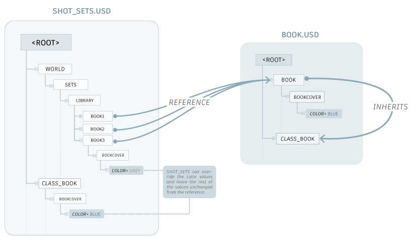

References are one mechanism that can be used to create a USD set, which is a single complex asset compiled from individual USD assets. References let you load the same layer file multiple times into a single scene in different locations, reusing scene description. This lets you load scene description (ie. a model, asset) from an external location without copying it into the contents of the layer referencing it. In the following example, shot_sets.usd is referencing the file book.usd.
Referencing is not instancing. Marking a prim as instanceable simply indicates that it can be instanced. USD decides if it is instanced or not as your scene is composed.
References are not given a type. In USD, references are typically a type-less def, which contains no information. This is useful when you reference a prim from another file, because a type-less def can easily take on a prim's type without interference.

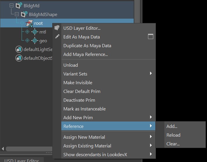

Add a USD reference to a prim in the Outliner
  1. Right-click the prim you want to add a reference to.
  2. Select References > Add....
  3. In the Add USD Reference/Payload to Prim dialog that appears, select your reference file using the file directory.

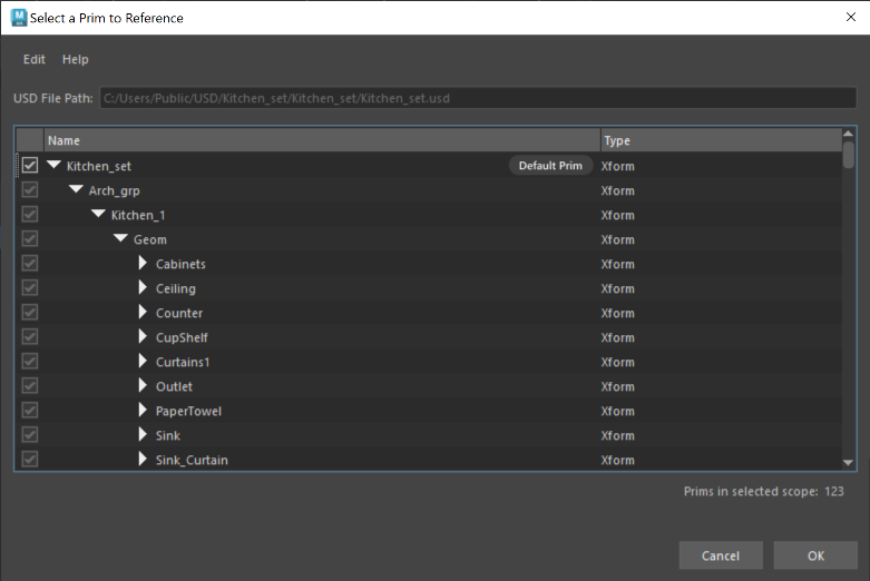

    1. For the Prim Path field, leave this field blank to use the default prim as your prim path (this is only viable if your file has a default prim). Specifying a prim path will make an explicit reference to a prim. If there is no default prim and no prim path is specified, no prim will be referenced.
    2. Use the Select button to open the Select a Prim to Reference dialog and specify which prim you want to set as your default prim/ reference in. Use the reset button to refresh your prim path to what it was before you made any changes.

Reload/Clear a USD reference in the Outliner
You can reload references, payloads and nested references for prims using the context menu. To reload a reference, right-click on the prim and select References > Reload. You can also clear a reference by selecting References > Clear from the same context menu.
