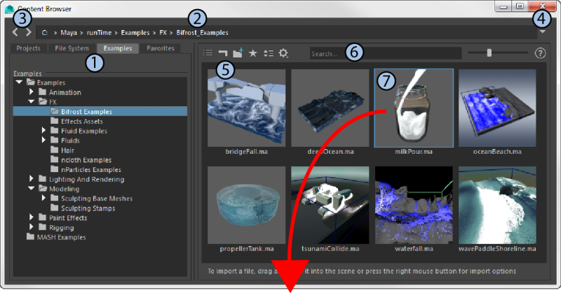

In the Content Browser, you can navigate through folders in different locations, search for files in the Content panel, and then import or reference those files.
Navigating the folders
Expand the folder structure in the browsing panel on the left and select a folder to display its contents in the Content panel on the right.
Element in Content Browser |
Lets you do this |
1: Tabs in the browsing panel |
Find the location of the data you want to load, then expand the folder structure and select a folder to display its contents in the Content panel:
2: Path bar |
Select or enter an absolute path to find content:
3: Back/forward arrows |
Navigate among the previous and next locations you have already visited. |
4: Navigation arrow |
Open a menu that displays the recent navigation history. Select a location to go to it. |
5: Go Up One Directory Level icon |
Click the
6: Search field |
Search the contents that are currently displayed in the Content panel - see below for details. |
7: File |
Import a file into your scene in different ways, such as by dragging and dropping it into a view panel. You can also reference the contents of the file - see below for details. |

Importing or referencing files into the scene
You can import one or more files from the Content panel into your scene, or you can reference them. When a file is referenced, its contents are visible in your scene, but they're not loaded into the scene. You can manipulate and edit objects from a referenced file, but any edits you make remain in your current scene. The original objects remain untouched in their original file - see File Referencing for more information.
To import one or more files
- Double-click a single file.
- Drag and drop one or more selected files into the view panel.
- Right-click one or more selected .ma, .mb, or .fbx files and choose
Import. You can also click the
icon to open
Import Options.
- For .mel files, right-click and choose Source mel file.
- For .py files, drag and drop them into the scene to automatically execute their onMayaDroppedPythonFile method.
- For sculpting stamps, right-click and choose Use selected stamp - see Stamps for more information.
- For image files, right-click an icon and choose one of these options:
- Open file as normal file texture: For normal textures, Maya applies a texture map according to the geometry characteristics—textures are placed onto polygons based on UV information or placed onto NURBS surfaces based on parameterized information.
- Open file as projected file texture: To create projection textures, Maya applies a texture map to the surface of a 3D object by projecting a 2D texture into 3D space—in other words, Maya projects the texture maps independently of the geometry characteristics.
- Open file as stencilled file texture: Lets you place an image file or texture on a surface and manipulate its placement and size to look like a label. You can use masking techniques to hide unwanted parts of the image.
