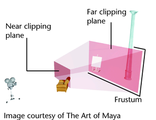

Near and far clipping planes are imaginary planes located at two particular distances from the camera along the camera’s sight line. They determine how much of a scene is seen by the camera in the viewport. Only objects between a camera’s two clipping planes are rendered in that camera’s view. Any parts of objects in the scene closer to the camera than the near clipping plane or farther from the camera than the far clipping plane do not appear in the viewport.

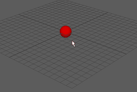

A camera with a Clipping plane of 40. The grid disappears as the camera pulls near.
