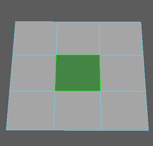

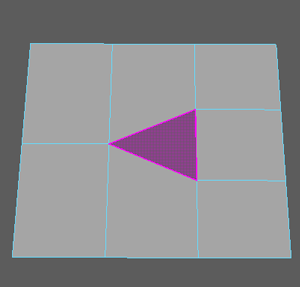

- Move the cursor over a hole while holding Shift.
The Quad Draw tool enters face preview mode. If the face to be created is a tri, it will highlight purple:
Whereas if the face to be created is a quad, it will highlight green:
- Shift-click the face preview.
A new face appears, filling the hole.
