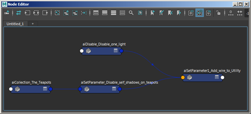

This short tutorial will cover how to use the set_parameter, collection, and disable operators to change the lights and self-shadowing of some teapots and alter the shading of the sphere. The scene contains two lights casting shadows on three teapots and a sphere with a simple utility shader assigned to it.

Collection
We will use the collection
operator to reference a selection. This can be used to avoid writing a selection multiple times (optional in this case).
- Create a
collection
operator containing two teapots. Underselection
add the following (we will apply aset_parameter
that will only affect these two teapots):
Teapot001Shape or Teapot002Shape
Teapot Collection
Set Parameter (Disable Self Shadows on the Teapots)
- Create a
set_parameter
. Create the following expression:
self_shadows=false
Disable Light
We can turn off one of the lights by using the Disable operator.
- Create a Disable operator and under Selection enter for the following Arnold light:
ArnoldLight001 disabled
Set Parameter: Sphere Utility Shader
Now we will change the overlay_mode
for the spheres utility
shader.
- Assign a
utility
shader to the sphere and rename it to the_utility. - Create another
set_parameter
and underexpression
enter the following:
overlay_mode="wire"
- Under
selection
Utility shader altered with Set Parameter
Final Operator Graph window setup
