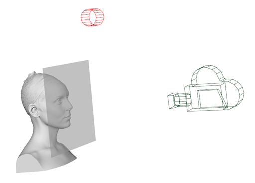

  • Import the head model into the scene.
  • Create a cylinder or quad area light and position it above and slightly in front of the head model. Increase the lights exposure to around 4.
  • Create a polygon plane and position it in front of the head. We will use this plane to refract the rest of the head using the same texture map.
  • Create a camera (rename it RenderCam) and position it so that it is pointing at the front of the head.

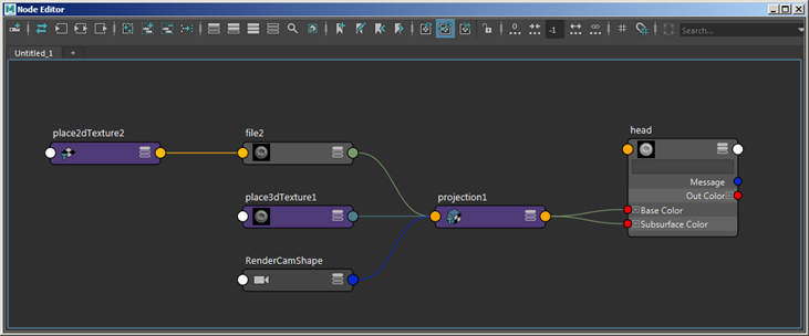

  • Assign a standard_surface shader to the head model.
  • Create a camera_projection shader and connect it to the base_color and subsurface color of the standard_surface shader.
  • Create an image shader. Open the texture file in the image shader. Be aware that some images work better than others. It helps if you use an image with a lot of contrast. It will give more variation in the refraction which will give the effect that the head is distorting and breaking up more.
  • Connect the Image shader to the projection_color of the camera_projection shader.
  • In the camera_projection shader, choose RenderCam in Link to Camera (under Camera).

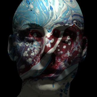

Head model render (without plane)
Head shader

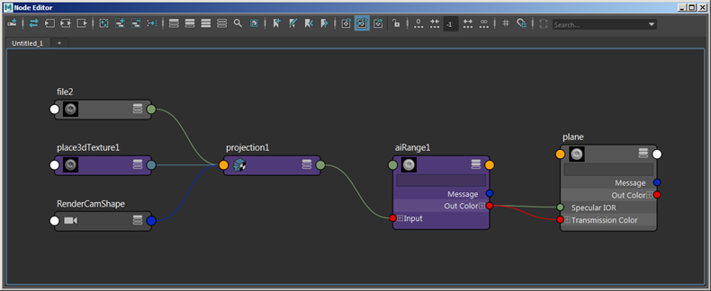

  • Create another standard_surface shader and assign it to the plane.
  • Increase the transmission_weight to around 0.9.
  • Connect the same projected texture to the specular_IOR and transmission_color via a range shader. The range shader is used to define how much the texture will refract and can be used to fine-tune the effect.
  • Increase the output_max of the range shader to around 6 and the Input Max to around 2. Try experimenting with the other values of the range shader to get interesting effects.

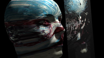

Output Max: 0 Output Max: 1 (default) Output Max: 6
Plane refracting head behind it
Plane shader
