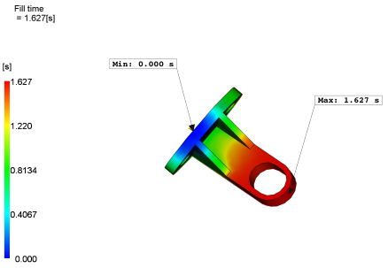

When interpreting the results, it is often valuable to identify the extreme values of the results and their location. The Show Min/Max tool locates the maximum and minimum data points on the geometry, and labels them with the result value.
  • Show Min/Max
You can also move the Min and Max labels for flexible usage.
