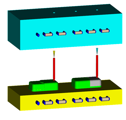

Figure 1: Overmolding model
Figure 1 shows the layout of an overmolding mold. The green colored first shot component is placed in the first shot cavity. The green colored overmolded first shot component and the gray colored second shot component are placed in the second shot cavity. The blue colored plate on top is the stationary mold platen and the yellow colored plate at the bottom is the rotational platen.
In this example, the polymer material of both shots is Polypropylene and the mold is P20 tool steel. The melt temperature of the first shot is 240 degrees and the melt temperature of the second shot is 180 degrees. The cycle time is 30 seconds and the mold open time is 5 seconds.

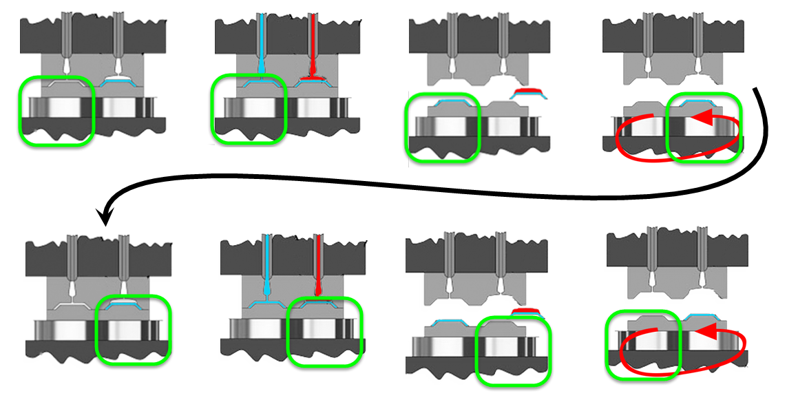

During a two shot sequential overmolding analysis, the mold rotates. However, the rotation is not simulated on the screen when the results are displayed. Thus, the results concerning the part circled in green in the Figure 2 are always represented on the left side of the screen for the whole overmolding cycle time.
Figure 2: Two shot analysis Process

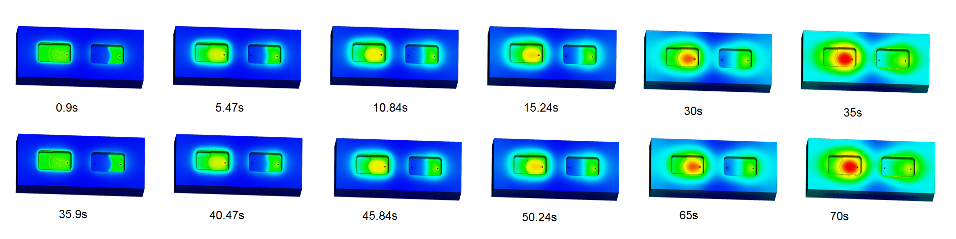

Let's take the example of the preceding model (Figure 1). The figure 3 and figure 4 show the mold surface temperature field plot of the rotational platen and stationary platen of two adjacent injection molding cycles. The temperatures on the mold cavity surfaces increase during each cycle in those mold locations which are in contact with injected polymer and are removing heat from the polymer. Mold cavity surfaces in contact with the previous shot (already solidified) have only a slight temperature rise because there is less heat to remove from that polymer.
In the Figure 3, the first line of results corresponds to a first cycle: the first shot is injected in the left-side cavity and the second shot is injected on the top of an existing first part in the right-side cavity. After this first cycle time, the rotational platen rotates, as shown in the Figure 2. The results displayed in the second line of the Figure 3 represent a second cycle time of an overmolding cycle time. The green part of the Figure 2 is represented in the left side of the screen.
Figure 3: Mold temperature of rotational platen

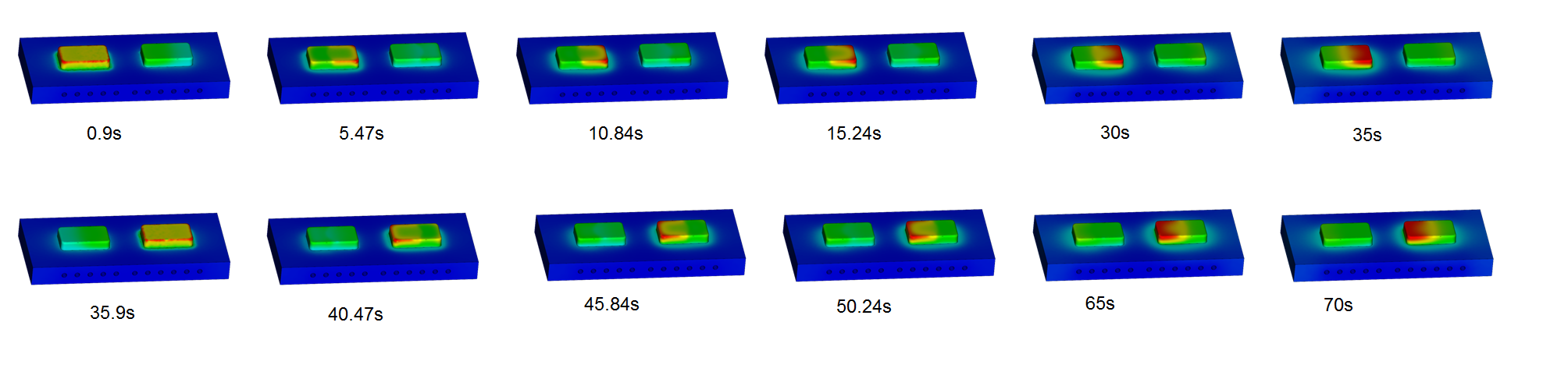

The Figure 4 shows the temperature field plot of the stationary platen. Both cycles have identical temperature distribution as the stationary platen does not rotate.
Figure 4: Mold temperature of stationary platen
