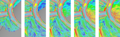

Figure 1 Intermediate fiber orientation tensor over time
Figure 1 shows the increase and then decrease of blue (low probability) tensors which illustrates how the fiber orientation tensor result changes through the injection cycle.

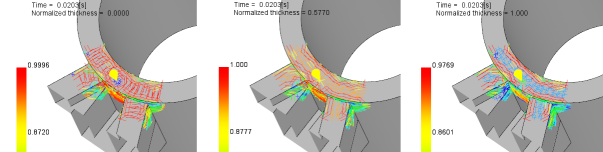

Midplane and Dual Domain analyses can also show the fiber orientation tensor at different positions through the thickness of the part at intermediate times if the profiled results output has also been enabled. A 3D analysis can only be displayed on the surface or cutting plane.
Figure 2 Intermediate fiber orientation through thickness
Figure 2 shows, from left to right, the fiber orientation tensor from the middle of the part to the surface for a Dual Domain analysis.

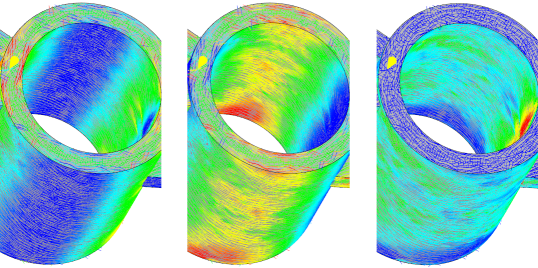

Fiber alignment in relation to a Cartesian Co-ordinate system can be displayed by selecting tensor components. This can be thought of as a 3x3 matrix. The Cartesian Co-ordinate system may be the Global Co-ordinate system or a Local Co-ordinate system defined by the user. The value of the matrix diagonal will always up to 1. The off-diagonal values represent the amount the alignments vary from the co-ordinate axes.
Figure 4 Intermediate fiber orientation result in the Txx, Tyy, and Tzz orientation for the Global Co-ordinate system
