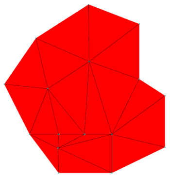

The model should appear as shown in the following image.
Three edges need stitching, one for each of the adjacent triangles. There is a very fine gap between the triangles that cannot be detected visually.
Click
(Mesh tab > Mesh Edit panel > Stitch Free Edges)Click and drag a rectangle around the three nodes that lie along the red line and click Apply. The edges are stitched.
You can also hold down the Ctrl key and select individual nodes along the edge instead of dragging a rectangle around the free edges.
Notice how the largest adjacent triangle has been split into two smaller elements in the process.

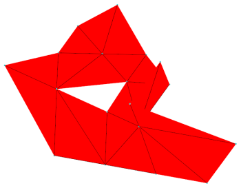

Click Mesh tab > Entity Navigator)and select T14997 from the drop-down box. Rotate the model until it looks similar to the image below.
It is not appropriate to stitch this triangle. Instead you could use the Fill Hole or Create Triangles as you did in an earlier task. You will use Create Triangles in this instance.
Click
(Mesh tab > Mesh panel > Create Triangles).Select Automatically apply when selection complete. When three appropriate nodes are selected, the triangle will be generated without the need to click the Apply button.

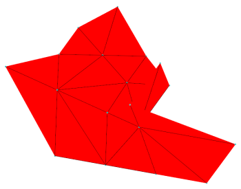

Select the three corner nodes of the hole. The element is added to the model automatically.
Click
( Mesh tab > Mesh Diagnostics panel > Mesh Statistics) to verify that all free edges have been removed.
