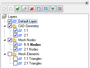

An illustration of the Layers panel is shown below. Several details should be explained:
- The bold layer is the active layer. Any new geometry that you create will be added to this layer. It is important, therefore, that you check that the correct layer is active, when you create new geometry.
- The layers that are checked are visible in the model display pane. All entities assigned to those layers will be visible on the screen.
- The highlighted layer is the selected layer. Commands you invoke from the layer ribbon are performed on the highlighted layer.
